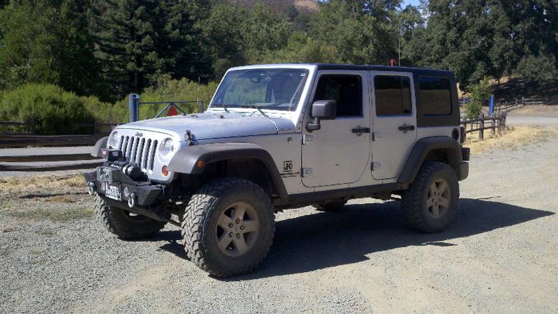

Welcome to the forum. If you are running only 33" tires then 2.5 lift is all you need. i am running 34" tires with a teraflex 2.5 coil lift and a 1"spacer all around just to lower the chance of high center.jku with bumpers winch.
