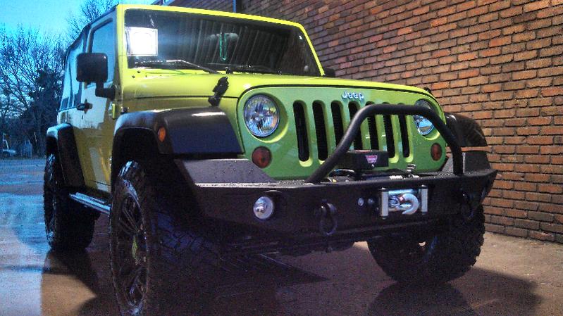

It is a well built, heavy bumper but you would expect that from Warn.
Other things I like (e.g. why I chose it):
[*]shouldn't impact approach angle[*]style ... especially the way the bumper ends work with the fender flares ... looks factory[*]the bull bar is sturdy and goes vertical at the top (e.g. doesn't stick out to far but should sort of act as a stinger if needed)[*]the large flat surface especially around the winch ... will be handy to set things on if needed[*]the winch sits between the frame rails which provides protection from the elements and doesn't affect airflow[*]You can reuse your factory fog lights[*]Lastly (and maybe most important for me) MADE IN THE USA
All the reasons I went with Warn, plus excellent customer service. I had an issue with the rear Warn Elite, and customer service was great helping me with remedy.
