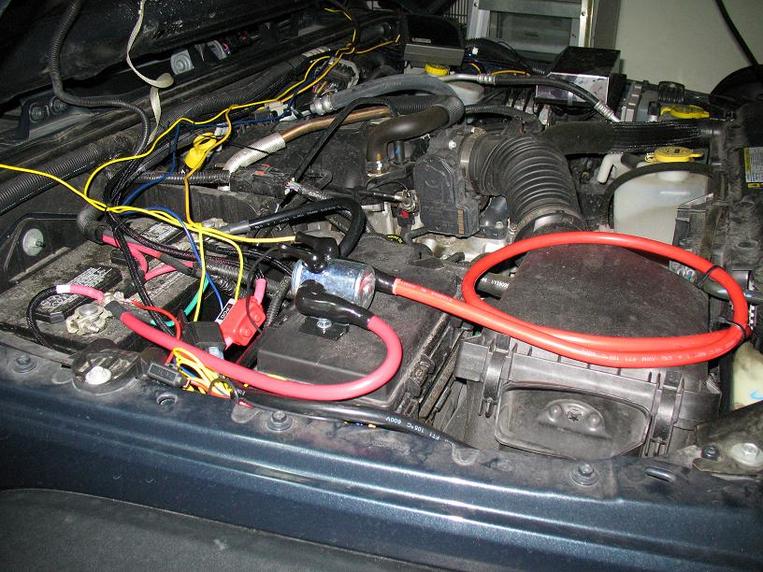

When I mounted the selonoid I lifted off the top of the fuse box, just to make sure my screws didn't go down into them, but there was still plenty of space, I think I used 2 inch self tapping screws. Let me know if this helps.
ID:	13231   Click image for larger version
