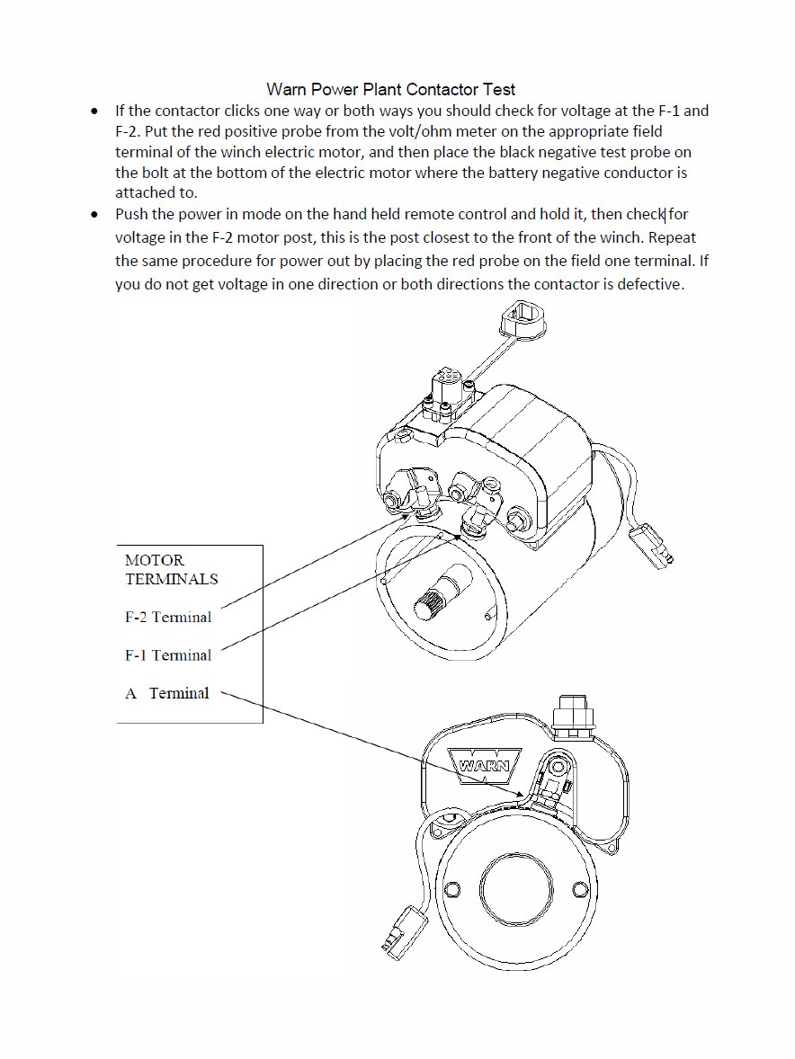

I had a different problem with my five year old Warn PowerPlant (now seven years old and running just fine). It would spool out, but not spool in. I contacted Warn and they sent me these instructions. The solenoid was bad. It is not cheap--around $230 IIRC.

While I had the PowerPlant apart I also regreased the gears. The lever for shifting direction had become very stiff and almost impossible to move. Took care of that, but boy there are a lot of tiny, complex gears inside of that and they all will fall out if you're not very careful!
