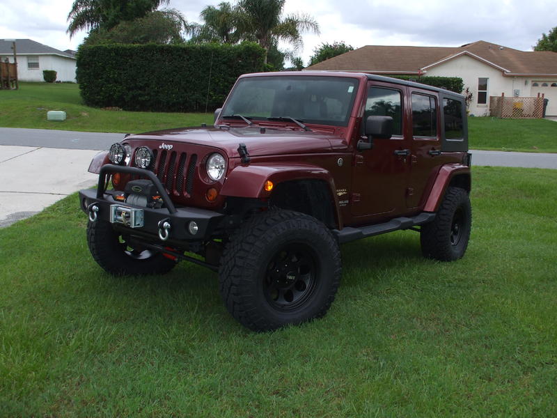

I went with the QT instead of the W. I wanted to be different so don't do like me.
Actually, after a little research, I found that pretty much everyone's "low end" winches are made by the same Chinese supplier including W. When deciding, I went with who I had the most service experience with. Turns out it was a good thing I went with QT because on my first re-tensioning the motor failed. I'm not saying it would have happened with the W. Maybe the W would have lasted 25 years. But what I do know is when I called QT and explained the symptoms they sent me out a new motor second day.
I'm sure more people personally like the W. Hell, I like W. If I ever get another winch (on my new 2025 Jeep Wrangler Italian Spaghetti-Western Edition) I might just get me an IP67 fully submersible to 1 meter rated W.
