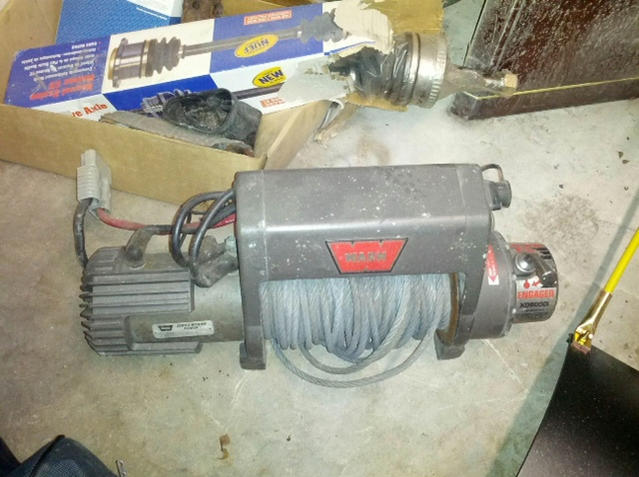

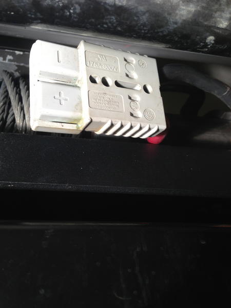

Here is the winch, and the grey harness/ plug I'm talking about that comes off the back of the winch... seems like there should be a connecting harness that bolts directly to the battery terminals?

Mine has the harness as well. That model winch was made to be portable and be switch from front to rear In a receiver hitch. That's why it has the harness on it. So it can be moved easily. You dont need it. You can just cut it off and extend the wires to your battery. Or order the plug from warn.
Old Oct 26, 2012 | 04:15 PM
jonesje2's Avatar
Joined: Dec 2006
Posts: 54
Default Wiring
If you decide to get crafty with it, the grey DC connectors are called Anderson Connectors and you can certainly buy them online. Sorry in advance if that is obvious and you already knew that.
