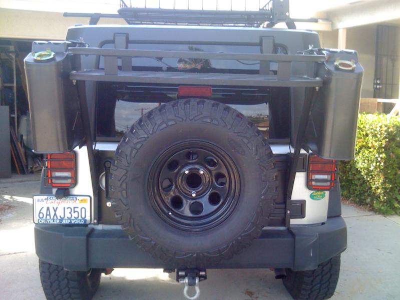

Got a reply from, Warrior. They sent me a word document with the installation. Looks pretty straight forward.
SUBJECT: P/N 831 - 07-09 Wrangler Adventure Rack Installation Instructions
IMPORTANT: Warranty and weight ratings are not valid unless installed with 920 series tailgate cover. We recommend the S920-1 version for most applications.
KIT CONTENTS:
Description
Qty
Description
Qty
Installation Sheet
1
Passenger Side Leg
1
Cargo Basket
1
8mm x 75mm Bolt
2
Driver Side Leg
1
5/16 x 2½” NC Allen Head Bolt
2
5/16” Flat Washer
4
5/16” Lock Washer
2
5/16” NC Hex Nuts
2
3/8 x 2” NC Hex Bolt
4
3/8” NC Hex Nuts
4
3/8” Lock Washer
4
3/8” Flat Washer
8
3/8” Wing Nut
2
Gas Can Clamp
2

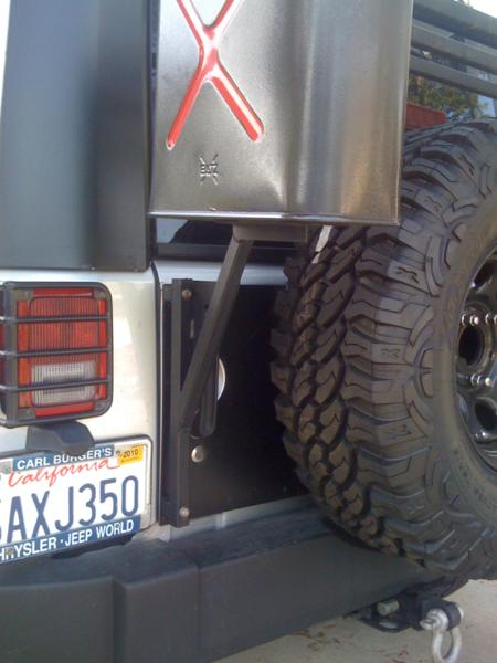

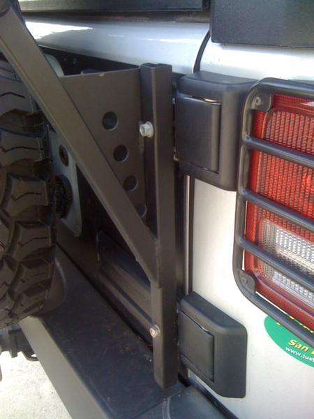

PHASE 1: LEG INSTALLATION
1. Remove spare tire from the rear of the tailgate.
2. Remove the plastic covers from the tailgate hinges; to do this you must open the tailgate, pinch the tabs on the inside of the hinge, and then slide them toward the driver side. If you wish to re-attach these, you will have to notch them to clear your Adventure Rack. Be careful that you don’t cut the cover into two pieces when notching.
3. On the driver side of the tailgate, measure mark, and drill 5/16” holes ½” from the left of the tailgate both 1” from the top and bottom of the tailgate, so that the hole spread ends up at 14½”. Use the two supplied 5/16” button head Allen bolt with flat washers and nuts to attach the driver side leg to these holes. The head of the bolt will be on the inside edge so as not to damage the weather stripping. See Fig. B
4. On the passenger side, unbolt the outermost bolts from the upper and lower hinge. Use the two 8mm supplied and two 5/16” flat washers to bolt the passenger side leg into the existing hinge mounting holes that you just removed the factory bolts from.
5. If you chose to notch your plastic covers to fit, now is the time to mark and cut the notches, then you will need to remove the passenger leg, attach the covers, and re-attach the leg.
PHASE 2: BASKET INSTALLATION
1. Place the basket on top of the legs lining the holes in the basket with the holes in the leg’s mounting plates. Use four 3/8” bolts with flat and lock washers to attach the rack to the legs.
2. Finish by placing the gas can clamps on the studs atop the basket, and secure using the two supplied wing nuts.
Tighten all bolts and check to be sure the rack is securely attached to the rear of the vehicle. A 50lb. Weight limit is advised. ENJOY YOUR NEW RACK!

I had one on my jeep for a couple of years. But i took it off about 6 months ago. It worked great but once I upgraded my stock tire and wheel package to steel wheels and 33s it was too much for my stock spare tire carrier to hold so I went with the ORFAB tire and Jerry can holder. The adventure rack would not fit on there too. You definitely need the steel plate for the tailgate as the stock sheet metal it way too thin to support the rack. The installation is pretty simple. As long as you don't mind drilling a few holes in you tailgate. Since I don't need mine anymore I'll sell it to you if you want.
