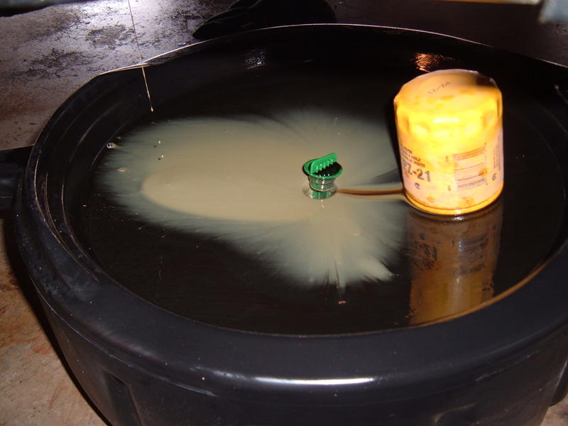

First oil change with the JK, decided to do the diffs just for the hell of it, and glad I did. No water crossings. No mud. Just dry trails and lots of city driving.
This is what came out of the front -

Looks like you were brewing Cappuccino. Props for finding a second use.
