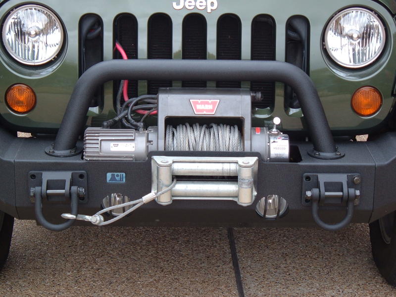

I mentioned the winch mount height for the XHD bumper. Has anyone had negative experience with a winch mounted too high, causing overheating problems due to radiator blockage?
'08 auto with trans cooler. No issues for me, plenty of airflow. Here is an old pic from back in mid '08 when I still had the caps on and hadn't re-routed the battery cables.
Name:	TX - Trk Jp 030.jpg
(waayyy back. Before the trans cooler. And before the little blue sticker even fell off... )
