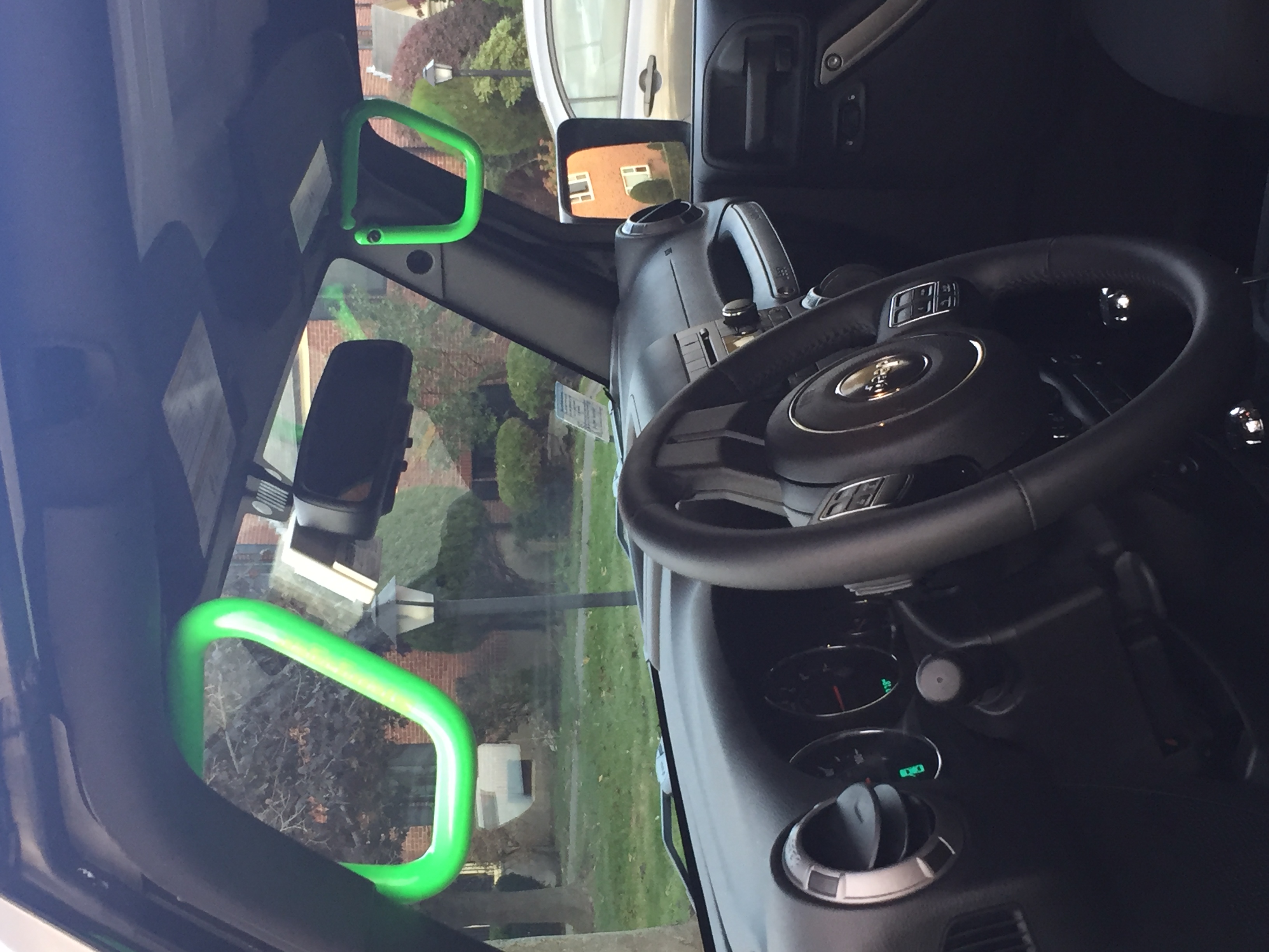

So, I gave up on the grabars pretty much right after this post. Great customer service I just didn't want to deal with tapping the holes etc. I stumbled across Stejager grab bars and brand in general. Maybe I have been living under a rock, but I had never head of them. They are awesome, and come in like 10 different colors
ID:	628117   Click image for larger version
