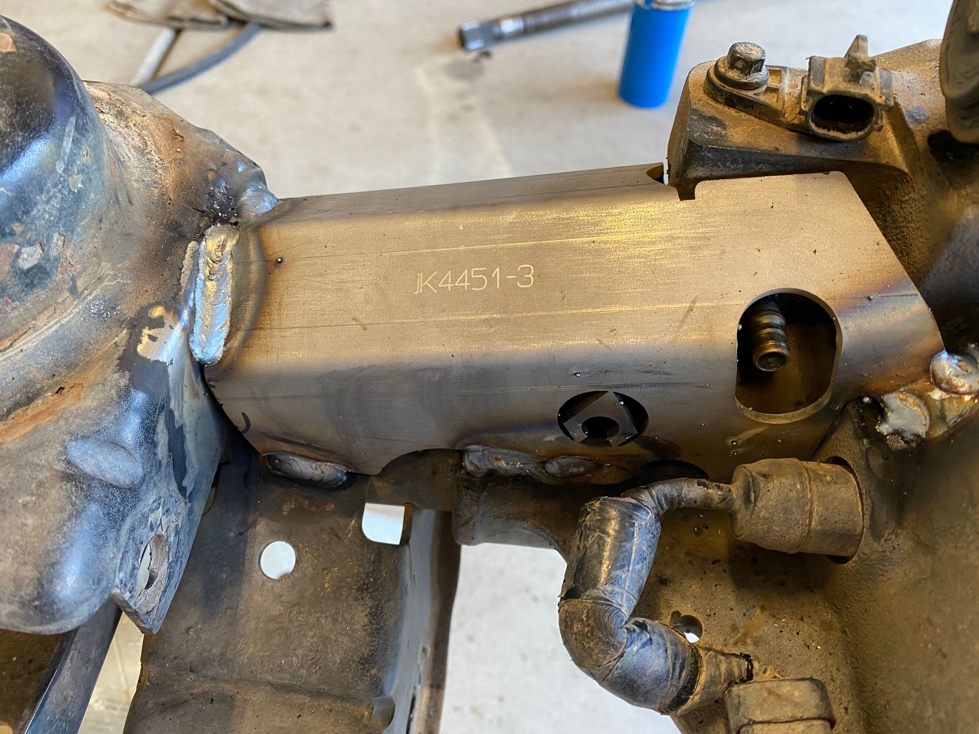

I got a good chunk of the welding done yesterday and wrapped everything up in a blanket. I’m waiting on the track bar bracket which will come in today. I think the welds are decent minus one goober weld spot which looks gooberish but I feel it will hold. I have another line to weld on the cast but I ran out of propane. Here’s where it sits as of now.

ok I showed this to my neighbor who is a certified pipeline welder with about 40 years experience and he said no. He is not a jeep guy or a car guy just a welder guy who welded for a living. He first said to get a good weld you need to really prep the area and have clean metal and he said that was not done here and he said it looks like poor penetration and that gas shielding was not properly done and a bunch of other stuff but bottom line he said he could easily see those welds not holding under any kind of stress. I hope he is wrong and it lasts and holds up to whatever abuse you put it thru.
