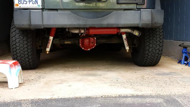

Originally Posted by tribulation138
Cherry bomb pro series 2.5inch in/out. Cost 57 bucks at pep boys. One can of high heat red spray paint 4 universal exhaust clamps 2 universal muffler hangers with a little custom fit A couple of adapters from summit racing <img src="https://www.jk-forum.com/forums/attachment.php?attachmentid=553306"/><img src="https://www.jk-forum.com/forums/attachment.php?attachmentid=553307"/><img src="https://www.jk-forum.com/forums/attachment.php?attachmentid=553308"/><img src="https://www.jk-forum.com/forums/attachment.php?attachmentid=553309"/> Pictures aren't the greatest. But you get the point. I went with the pro model because supposedly the internal design is made to cancel out the higher frequency exhaust tones while keep the low tone ones. I didn't want that ricey sound of a Honda civic. To my amazement its sound so good. No gargling or raspy sounds. I just have a simple down turn tail clamped on for now. Im glad to get that stock pos off. That thing ways a ton too!

Another pic.
