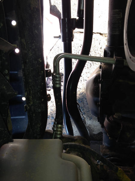

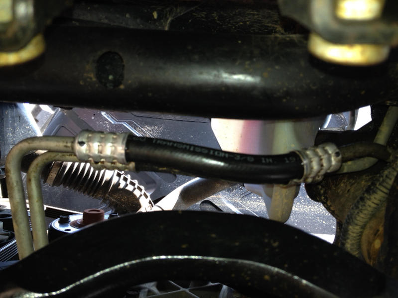

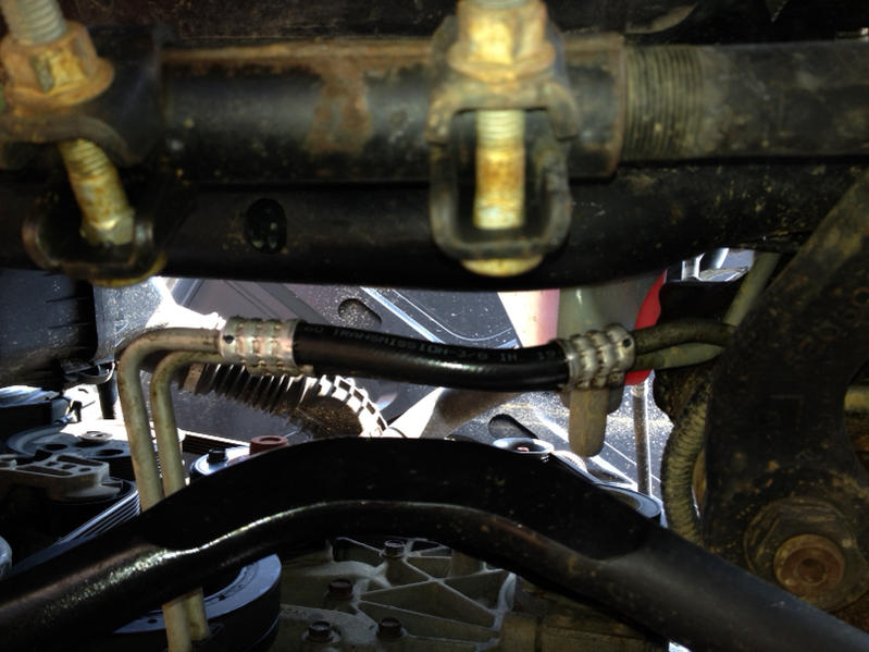

I have a leak from this spot. I'm not completely car savvy. plus it's still too cold out to really figure it out.

it's leaking at the spot between the rubber and the metal "crimp". I just need to know what to tell the mechanic or if it's easy, fix it myself.
Thanks!

Looks like A/C lines. might need to be replaced.

Trans cooler lines

There is/was a recall or TSB on the leaky trans cooler lines.

Transmission lines, mine leaked too and had to get them replaced.

Those are the transmission cooler lines. Jeep has extended the warranty on the lines to 7 years/70,000 miles for 2008 to 2010 JKs.
It's a warranty extension, so don't go looking for a recall.
