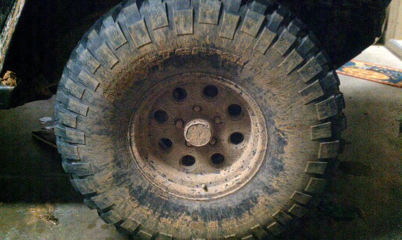

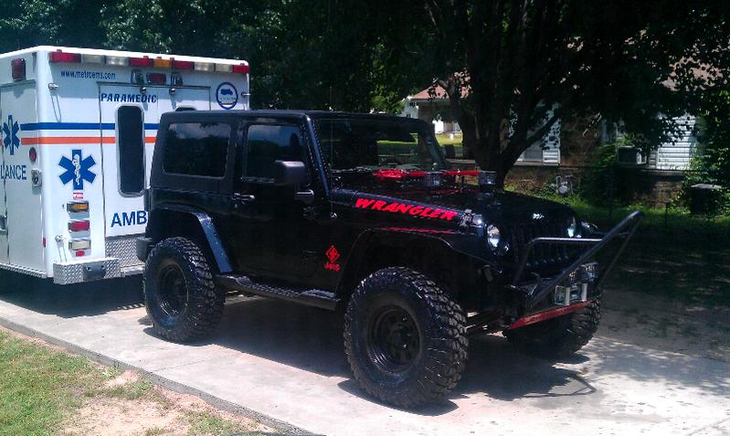

Old Jun 16, 2011 | 05:55 PM
medic_23387's Avatar
Posts: 997
From: Searcy, Arkansas
Here is a clean and dirty pic of my mb 72's
ID:	172432   Click image for larger version
