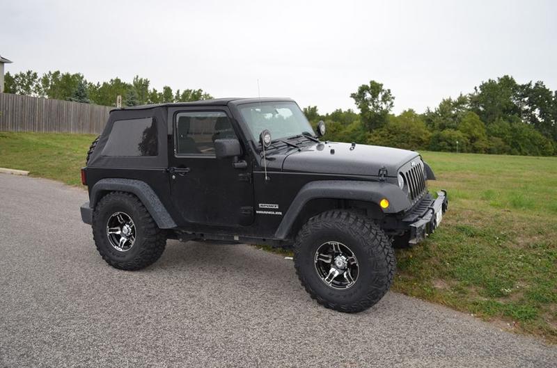

You may also want to trim your pinch seam.
If you don't plan on wheeling it before you are able to get a lift 35's will fit, you will need to stubby the front bumper, remove air dam and wheel spacers required if using stock wheels. My wheels are 3.75BS and 35x12.5r15 tires and didn't rub at full turn (only on bumper which was removed) If you plan on wheeling it this is not an option, I did this because I couldn't stand looking at my tires in the garage while waiting for the lift.

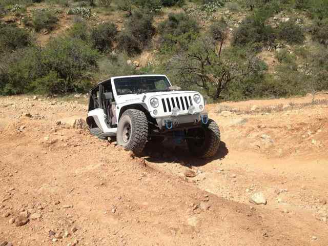

you can trim your stock fenders and pinch seam and run 35's with no additional bumpstop. This was 35's, 3.75" backspacing with factory bumpstops only. I do have a 2.5" lift, but the bumpstops were my limiting factor.
