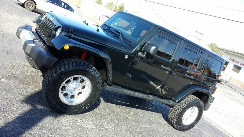

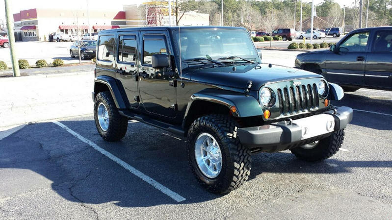

I also have to skyjacker 2.5 on my Sahara with 295/70/18's, love it....
ID:	534488   Click image for larger version
