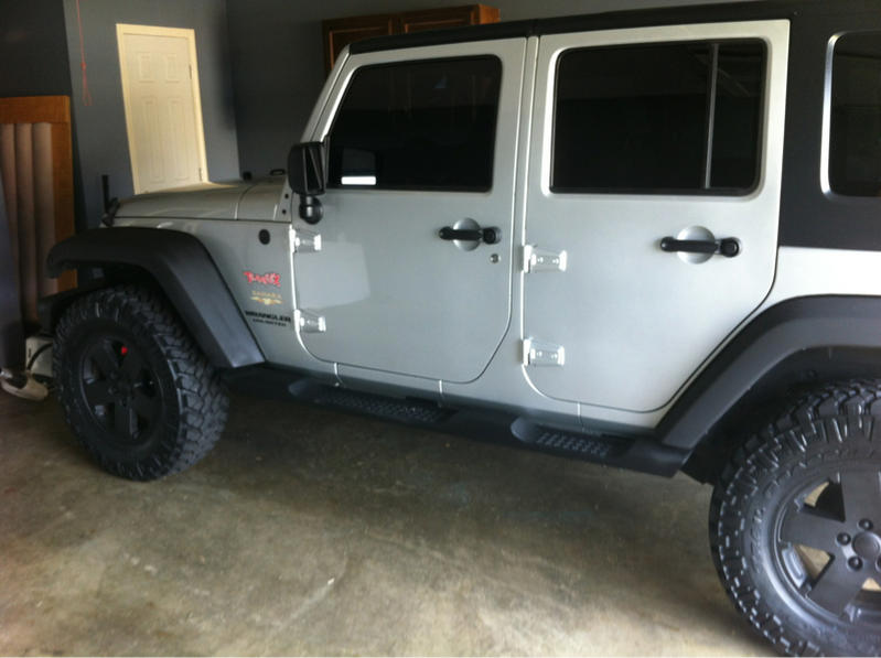

I have the teraflex leveling kit and 295/70/18 (34 od) trail grapplers. I have plenty of room
ID:	383715   Click image for larger version
Attachment 383717
That looks pretty sweet! Do you happen to have any other pictures from the side taken at a lower angle? It's kinda hard to see in that one outside picture just how much room there is in the fenders. Also, not sure how long you've had those Trail Grapplers, but how is the wear on them so far?
