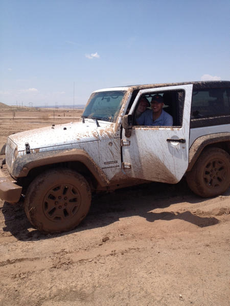

Hey guys I have a 2013 sport with 3.21 gears and I want to do a 3" lift with 35's. What exactly do I need to buy to make this work? Help please.

That's what my Jeep looked like before I started. Once you get started it gets addictive and you cannot stop.
