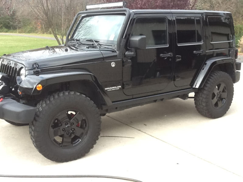

Here are the terra grapplers in 33x13" on stock Sahara 18's with a $50 1.75" leveling kit and 1.25" wheel spacers

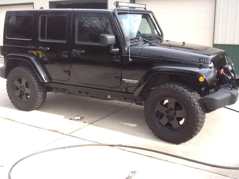

Middle pic are 35" bfg mt with same lift just added 1.25" body lift

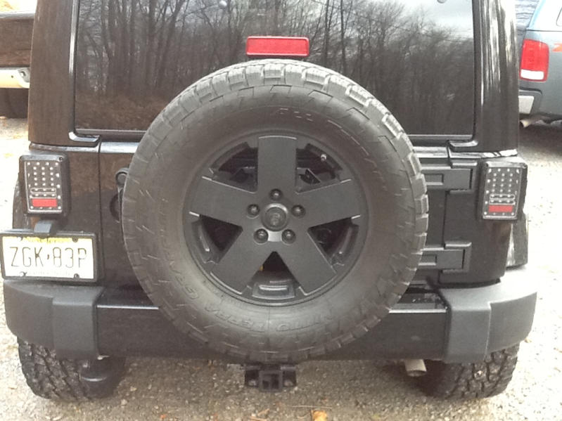

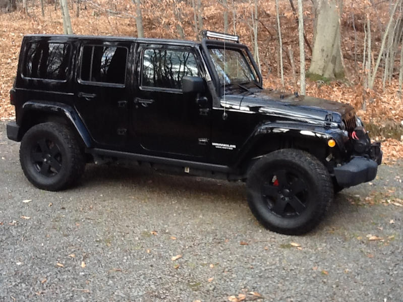

Here is the tire time line, all since July
Missing pic are a set of stock rubi 32" mt I had for a short while and jeep was not stock long enough for that pic
Stock gears 3.21's and auto trans
Stock nice wheels but tires too whimpy looking best mpg 18-20
Srt8 20x9 rims with federal 33x12.5 mt tires 15-16 mpg ok ride stock suspension
Stock rubi take offs nice ride tires still too small for me stock suspension 15-17 mpg
33x13 Nitto terra grapplers stock sahara rims 1.25 wheel spacer 1.75 leveling kit quite nice ride 14.5-15.5 mpg
315/70r17 kumho mt tires (34") ok ride little loud 14.5-16 mpg 1.75 leveling kit
35x12.50 bfg mt on stock Sahara rims 1.25 wheel spacers noticeable hwy hum 14-16 mpg 1.75 leveling kit and 1.25 body lift 15-16 mpg
Current setup
Regeared 4.56's
35x12.50r17 nitto trail grappler (they run 1-1.5" bigger than the bfg also heavier ) smooth quietest mt tire yet 3" full traction lift with 1.75 leveling spacers and body lift removed 14-17.5 mpg
