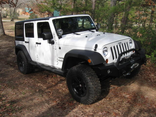

I also wanted to stay with the factory ride, so I went with Pro Comp 3" level kit (3 up front 2 in back) along with rubi shocks & 19/60 springs. With 305 x 75/17's & 4.5 backspace it has a good stance and handles good. With the weight of the winch & front full width bumper, the 19 springs kept it level.
Attachment 411552
I think I will go with a version of this..... I'm looking for 19/60 springs and rubi shocks. Maybe Daystar 3/4'' for the front to level out the rake and see what this looks like to start.... cheap yet effective and I think good enough for 275/70/17's. Thoughts?
