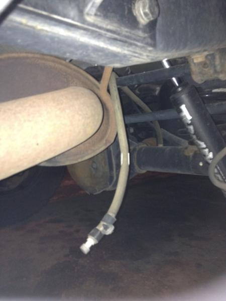

I am guessing this came lose but I don't know what it is and il assuming I just zip tie it to something?

That's your axle breather tube. It attaches up high on the frame with a metal clip on the hose.

its your axle breather tube... u should re-secure it as high as possible

Gracias.. I'll see if I can find the hole it's suppose to clip into
