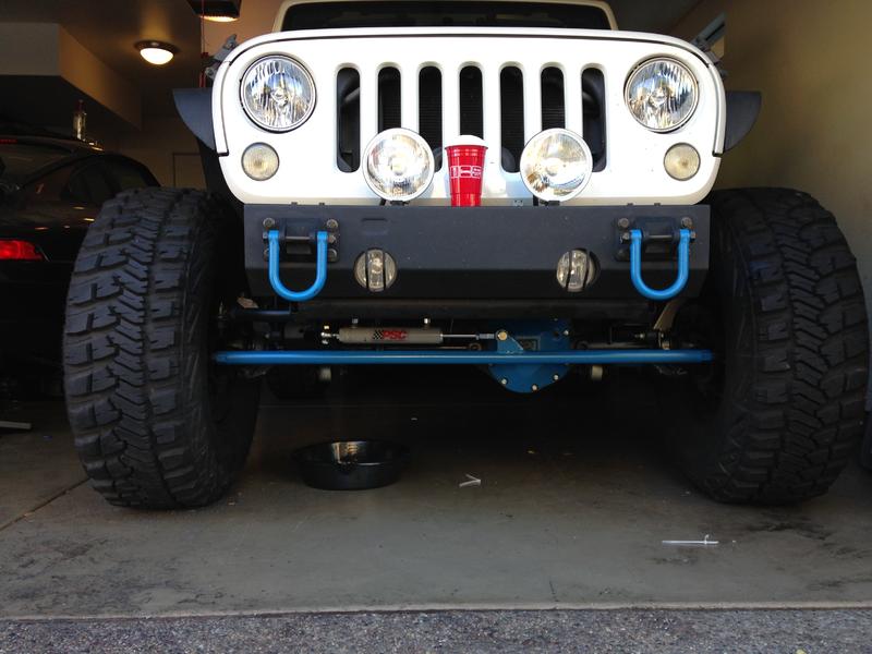

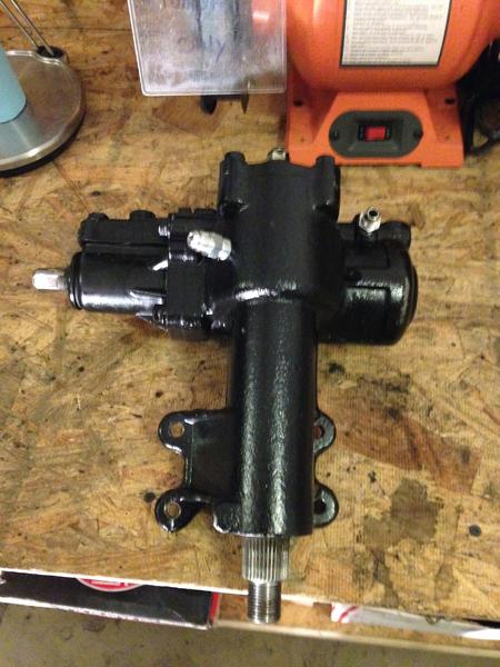

Originally Posted by 12JKjeep
yeah I thought about it but $2k is a lot rite now. Hopefully I'll be ok for the first year without it.
Piece the kit together and tap the box yourself. I did mine with ram, mounting hardware, tabs, hoses, and a 15" dual pass cooler for $300. Best thing I've done yet.

Do you have a write up on what you had to do? Or is it pretty simple for the most part. I have no idea what I'm doing with modifying the steering box. Thanks
Old Apr 27, 2014 | 05:01 PM
  #29
D_engel's Avatar
Posts: 2,539
From: Tempe AZ
There are write ups out there. Just google DIY hydro assist. Tapping the steering box is intimidating, but surprisingly easy. I've done it twice and the second one took me about 30 minutes (and it turned out better than the first one)
