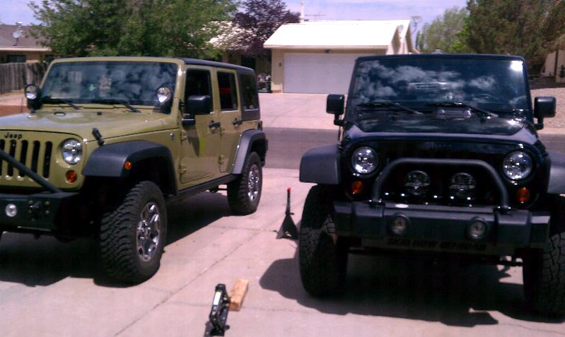

I have an RC 2.5" coil on my 13 and nothing else was required. The exhaust spacer is for the taller lifts. I helped a bud out with his RC and he bought me the RC single shock steering stabilizer. I would have gone a different brand buy I love the way it improved my ride. I would recommend a stabilizer down the road but not necessary.
