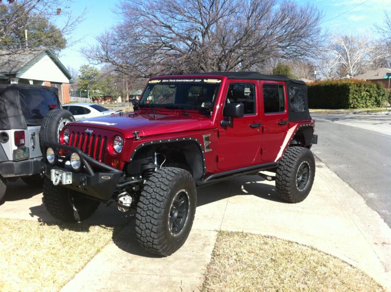

I have 538's on 37/12.50 18
Attachment 273157
the op has a 2012 - not the same thing
<img src="https://www.jk-forum.com/forums/attachment.php?attachmentid=273157"/>
Badass jeep how big of a lift do you have. And what rock sliders are those
