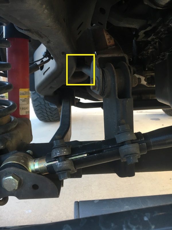

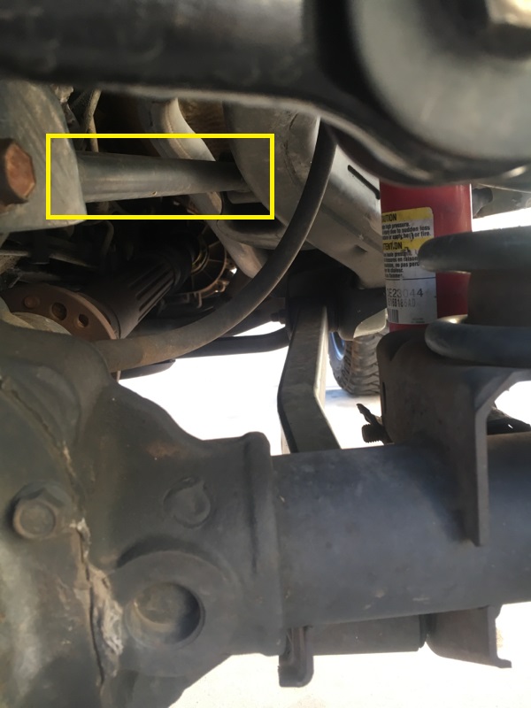

Don't know if it's the angle of the pic or my eyes. But it looks like the drivers control arm has more of a bend to it.

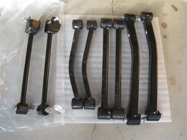

You really need to measure all the arms. And straighten your steering wheel. It only takes 10 minutes.
Basic Do-it-Yourself Jeep JK Wrangler Front End Alignment
Is the driver upper CA straight and the passenger bent? Hard to tell from the picture but on my '14 they were both straight as you can see from the picture of my take-offs.

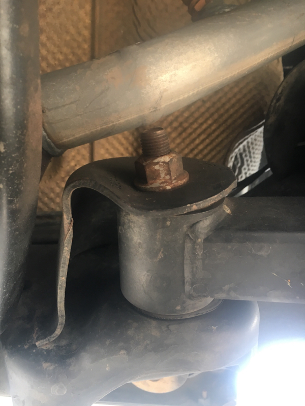

Found the issue... drivers side lower control arm mount is bent.. a few months ago this lady cut me off and forced me into the curb on the median... so my next question is wtf do I do now??

Cut it off and weld on a new one. Go heavy duty with it at the same time.
That doesn't look like a 2" variance to me so you may have more going on.
Jeep JK HD Lower Control Arm Mounts
Yup... if it was enough to bed the mount, probably look at the control arm and the mount on the axle side too.
Old Oct 18, 2016 | 01:51 AM
sea bass's Avatar
Posts: 998
From: Enumclaw,WA
X2
I mangled mine when I rear ended a vw bug. Pushed my axle back a few inches on the drivers side - had to cut it off, weld on new ones, and got adjustable LCA's to get caster in check.
I bet that's where the additional distance is from. The frame mount didn't look like it would cause it to be off that much - bet the arm is tweaked and bushing is f'd up.

Originally Posted by AJ_
I'm assuming a lot of my problems are coming from this coil spring spacers. The only variable I see is the drive shaft. It's the only thing I can see pulling the drivers side back. It drives meh, pretty squirrelly whenever there are lines in the road and some steering wheel play. Esp and abs lights are on but I assumed it was from the steering wheel being upside down
Take a straight edge and place on the left lower control rod and measure the gap at the bend and repeat on the passenger side. From the pics it looks like the drivers side is bent inward more. It could be just the angle of the pics.
