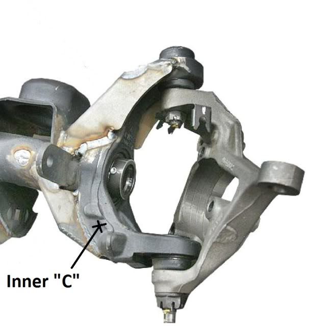

Note that this picture ronjenx posted of the C has gussets welded top and bottom.
