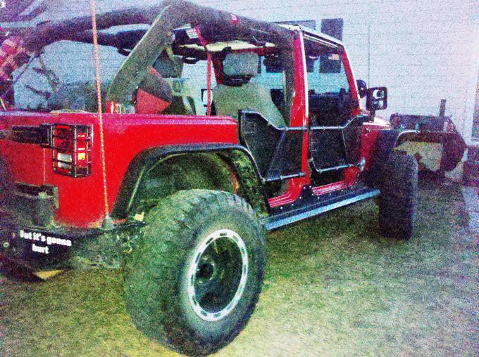

35x12.50x17
ID:	450525   Click image for larger version
