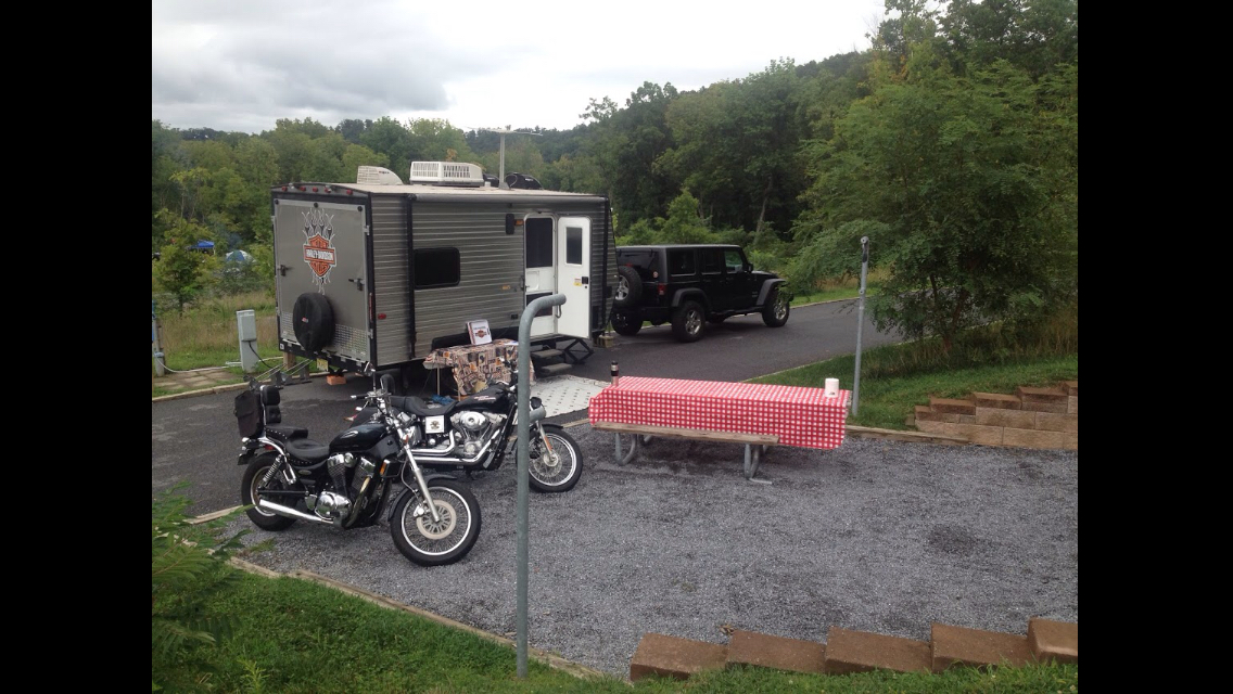

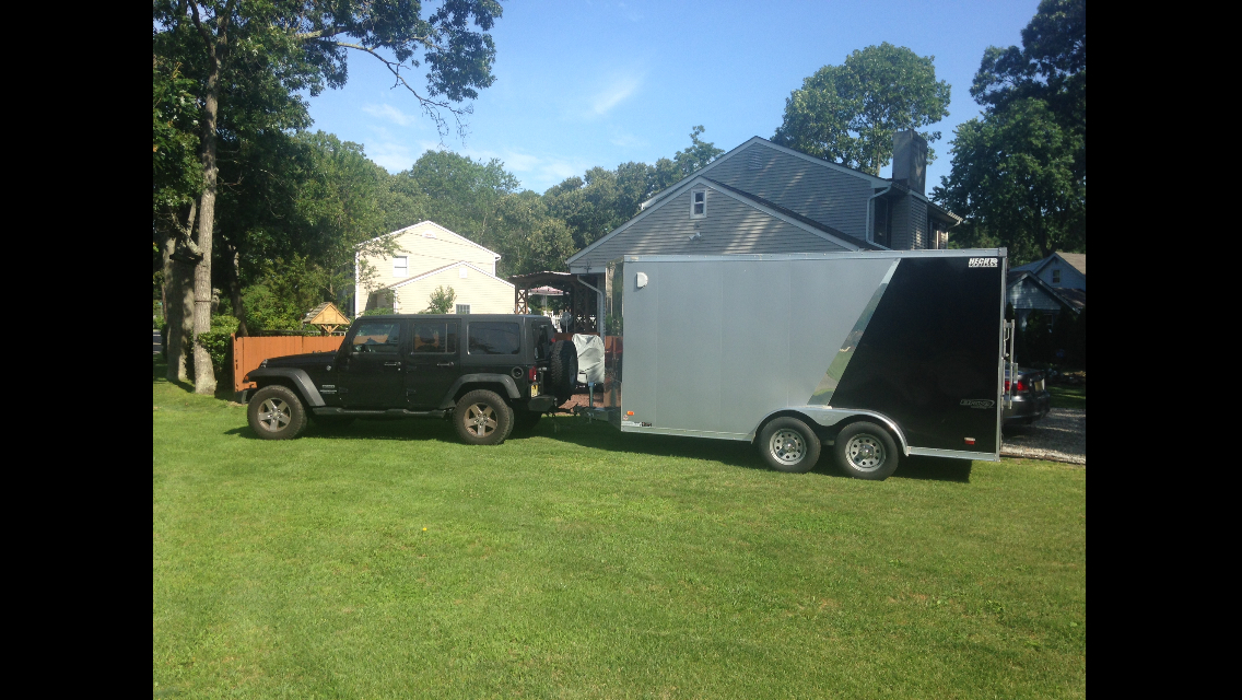

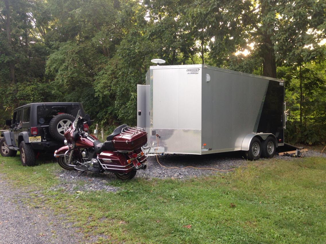

I've towed 5000 pound toy hauler for many trips and miles with my 2012 jku Sport S. I used a weight distribution hitch. I also have the smittybilt XRC rear bumper that increases the hitch capacity to 5000 pounds. My suspension is stock. Also, don't listen to anyone telling you to put Rubi springs on. They are no different from Sport springs. As long as your pop up is not huge, you should be fine with the stock setup. I replaced my 5000 pound toy hauler with a 3500 pound loaded weight trailer and I tow that about once per month on the east coast. I love the smittybilt bumper. So much more confidence in its strength compared to the stock receiver.
