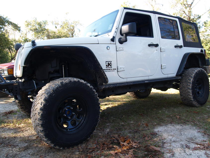

This much lift and better rear ends
My 35's look like oreo cookies
