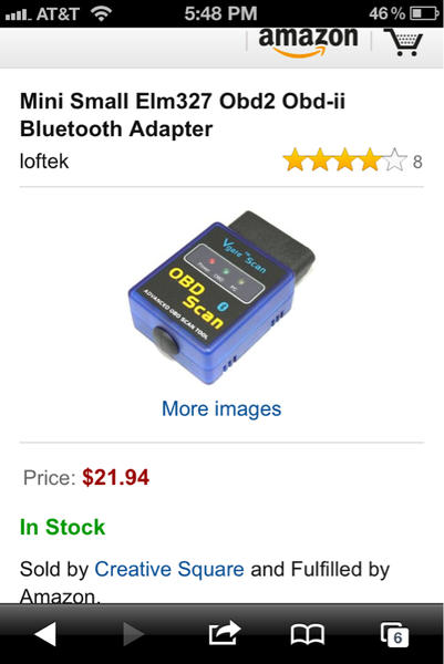

Someone makes a Bluetooth plug-in and if you have a phone you can get free software for it.
Here is one iPhone option. Now all you need is a place to mount your phone while driving
Now that looks cool and I have an old andriod phone I could dedicate. Any idea who makes the reader hardware?
Here's one of the ones I'm looking at, but there are a few out there. Torque makes one and
here is a PLX Kiwi
Edit: couldn't control where they go, coiled one is PLX Kiwi

I guess there are a few options for the bluetooth interface. I'm reading the "torgue" application for andriod is pretty good.

Well this one has gotten a few hundred reviews on Amazon and looks exactly the same as ebay models that cost twice as much, but have Jeep listed in the title.
Soliport ELM 327 Bluetooth OBDII OBD2 Diagnostic Scanner
For 22 bucks, I'll let you know how it works out. Thanks for the advice.
