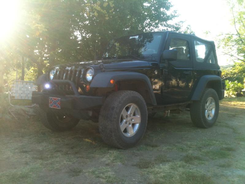

I just installed a 2inch superlift budget boost on my Wifes 08 it was a super easy install and was only 325 with shocks and it rides great..
