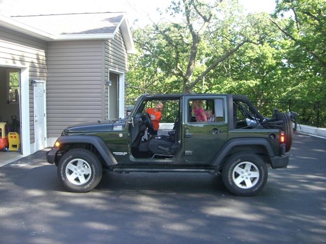

ACE Rails have been awesome for myself and my family. Needed something for the family to use to get into the jeep but also wanted something for the occasional offroading. The gap you talk about is not that bad without rubi rails. Twin 5 year olds and a 2 year old and haven't had a problem with them yet. Can't beat the price and they were simple to install (beside the grinding of the washer). Great warranty also.

the gap is GOOD as I mentioned in the second post. I've seen ace rails damage the body when run in conjunction with Rubi rails. By eliminating the gap, you remove the ability of the sliders to bend a bit when on rocks so all that left if pressure on the rubi rails and body.
The ace rails are great choice from a price to strength perspective. Just be careful if you run them with Rubi rails and tend to hit rocky terrain while off-road.

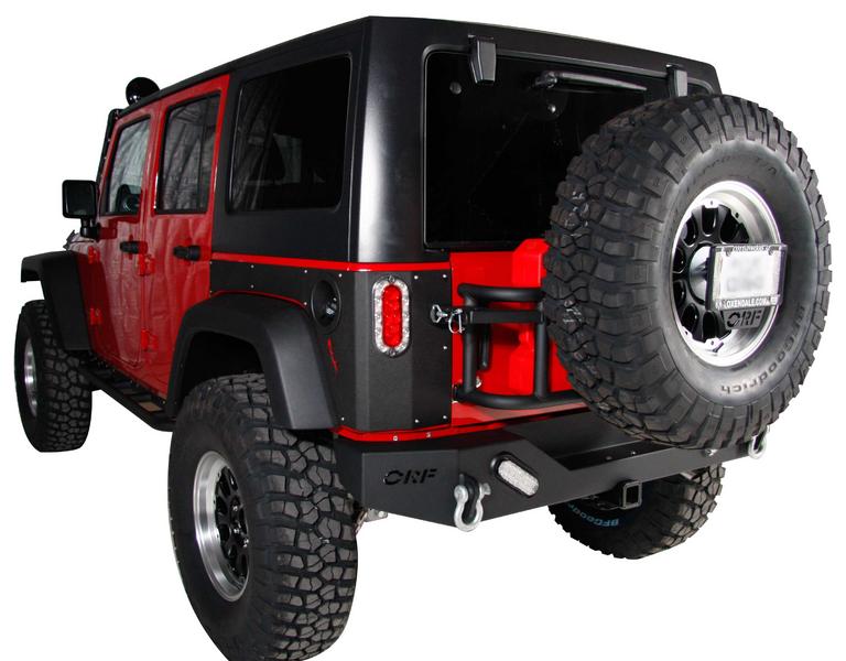

OR-Fab's rock sliders are very stout. The heavy duty bars are manufactured from .120 wall steel tubing. They offer great trail protection and ground clearance while giving you that side step for the misses....

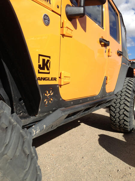

We have two versions
( black jk )version can be used as a step
dozer Jk) high clearance
