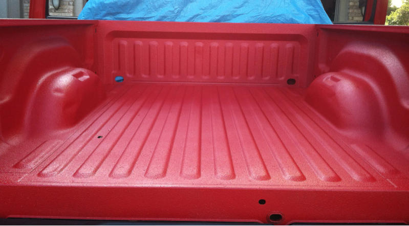

Texture came out great... Just like lineX. Compressor I believe was a 3 gallon

That looks great. Really shows that you don't need to have a massive compressor to get it done.
Dodge Ram??
