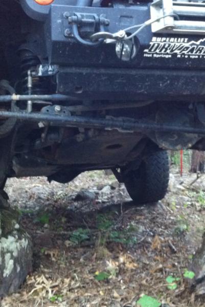

I'm running an evap skid, skid row oil pan and tranny skid, & front RR skid.
