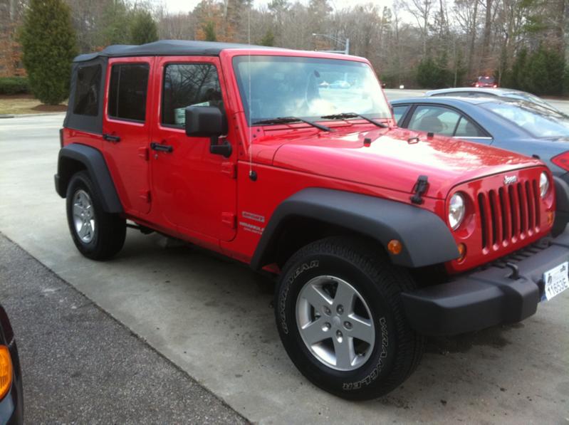

I'm new to the jeep world and would like to set up my 2010 JK unlimited sport for all purpose. But I'm not sure what upgrades would be best to do first ? Any help would be appreciated.
I already swapped stock rims and tires.
