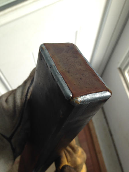

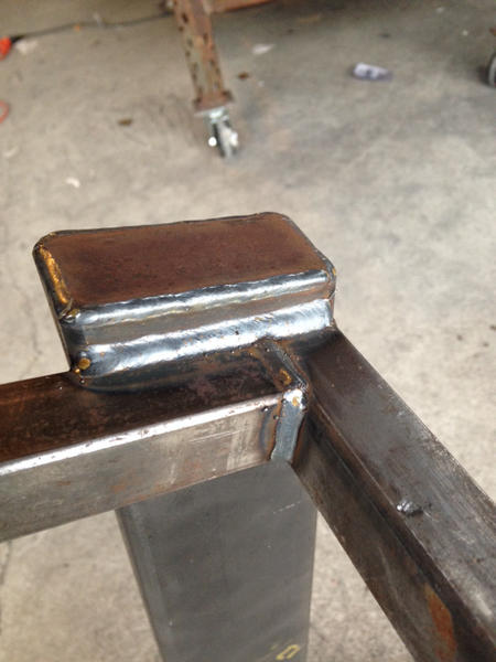

Yup - I just mine about 2 weeks ago from them. . Freakin love it! Miller is running crazy rebates on the 211 right now too. You can get it down to close to the same price.
I'm in the middle of welding up a mig cart right now and I'm loving the 210 MVP - big difference over a 110.
