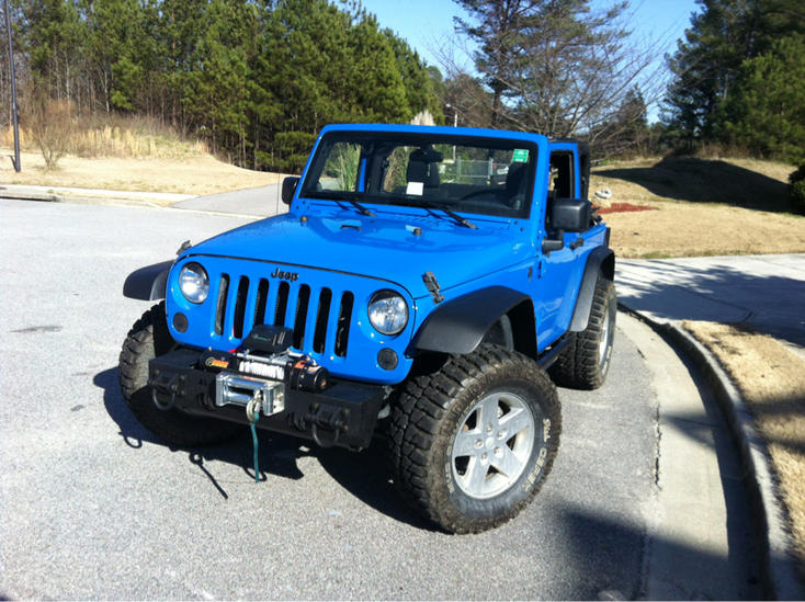

Old Jun 2, 2013 | 07:26 AM
TristanWomack's Avatar
Posts: 142
From: Georgia
I have the stock 17s and 305/65/17 dick cepek mud country's. the rugged ridge 1.5 inch wheels spacers work nicely and no rub off road. No lift either.
2012 sport S cosmos blue 2 door. rugged ridge tail light guards. kicker subwoofers. clarion cx501 head unit. kicker replacement sound bar speakers. Rockford fosgate amp. rugged ridge flat fenders. rugged ridge wheel spacers. 33x12.5r17 dick cepek mud country tires. Rampage Retractable rock rail/side steps. RR XHD stubby front winch bumper. Quadratec Q9000 winch.
