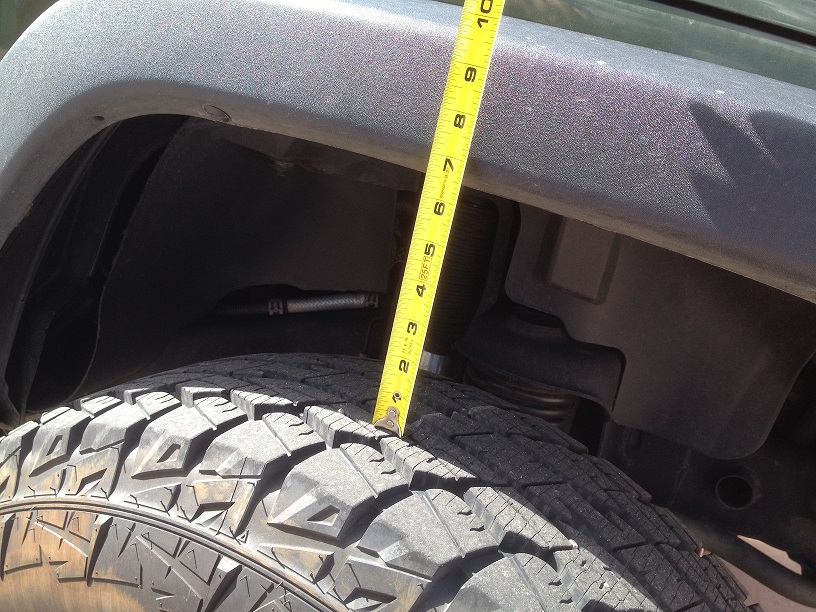

No experience with RK coils, but here is my 3.5" MC's with 37" Falkens and stock flares (admittedly, it's relatively light. No armor or overlanding gear.). Chop the flares, and I would have over 9" of clearance between the tire and fender. Can't imagine that you are heavy enough to chew through all of that.
