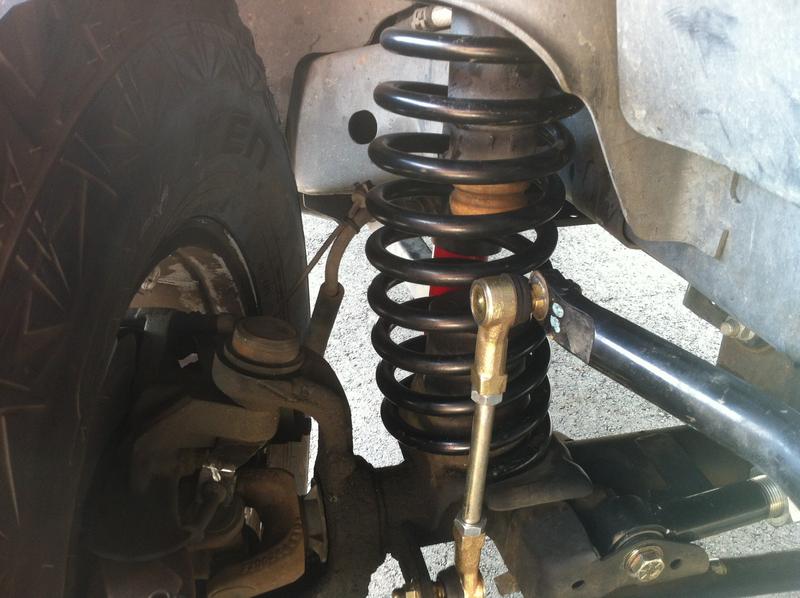

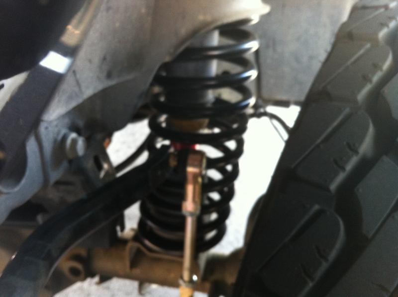

I noticed that my springs look bowed. This might be part of my problem too. What the heck?

You solve your wobble yet? And I think your springs are bowed because the axle is shifted because of the lift. Trackbar should fix that.

I already replaced the track bar with an adjustable one. Axle is now centered. And the springs bow in opposite directions towards the tires. It looks like they start off-center at the top based on where the upper bump stops are inside the springs. I'm wondering if we didn't get them in the right spot in the upper seats.

And the wobble hasn't happened since I replaced the track bar and used 9/16 bolts, put on new tires, properly seated the bottom of the passenger side spring (it wasn't in the notch) and aligned the front end. I suspect that spring was contributing factor. Now if I can just get the bow corrected I'll be golden (and ready to focus on what mod to do next).
