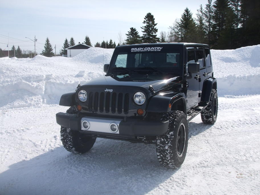

I'm currently running 18 X 9 procomp 8179 with 4.75 back spacing, works good but my new summer rims are gonna be 18X9.5 with 4.5 backspace

i got 4.5 BS ans 285 tires, the sire is flush to the fender

Goldorak - what are the specifics of your tires (size).
I'm curious because as you can tell, I want to move my whole set up flush with the fender flares. However, my tires are 12.5" wide. From the picture yours looks about 11" wide or so. So, I'm curious about your tire specifics.
