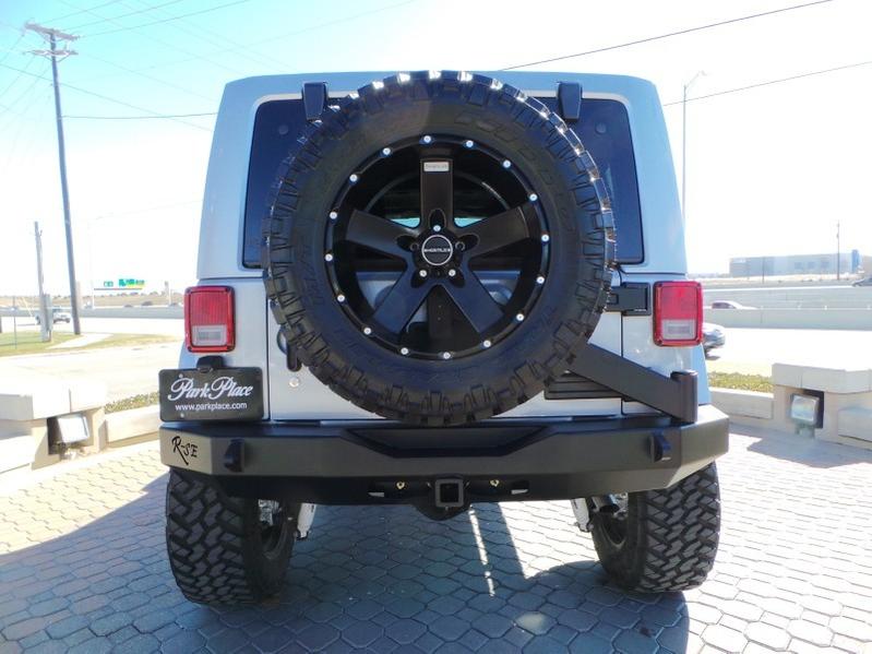

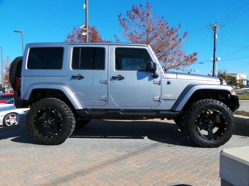

As an FYI - here is a JKU with the rims on it - did they do something special to get these rims to fit?

Those are ~4.75" backspacing, so they should work without the need for wheel spacers or anything else. I ran 10" wide wheels without any problems, albeit 15's instead of 20's.
