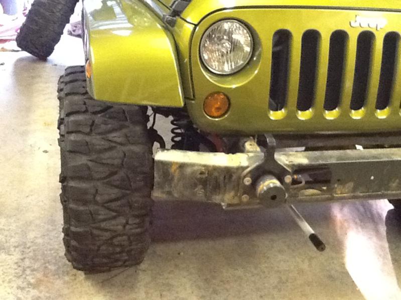

I'd probably do 4.25" to 4.00" at a max. I bought some Spyderlocks and they are 17"x9" with 3.5" backspace. I think I have a cell phone pic showing how far out past the fenders they stick out. I'm running 35x12.50 Nitto Mud Grapplers.
