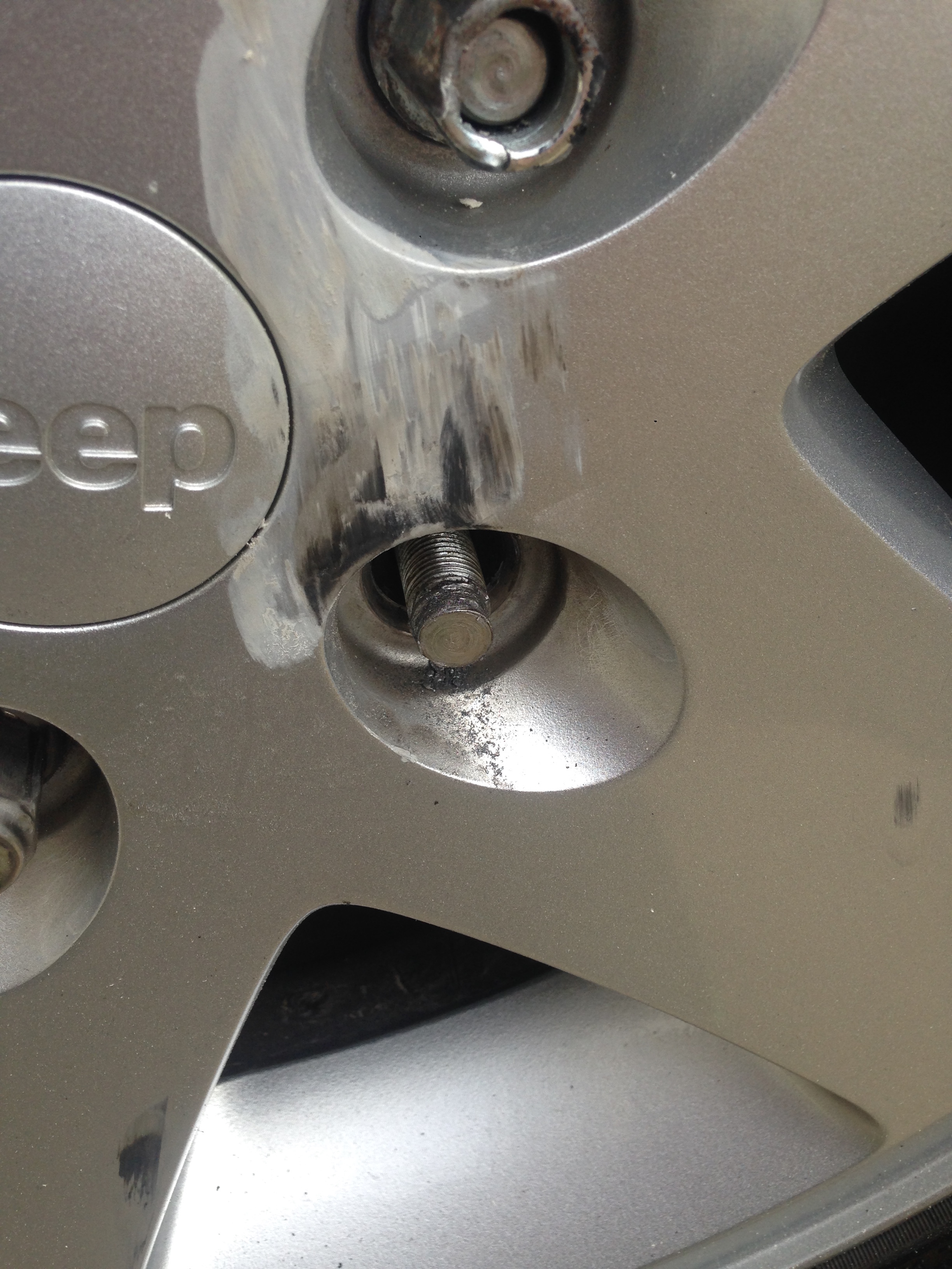

Top nut shows crappy lug ... middle stud was warped and totally destroyed upon removal ... I tried to straighten the stud for removal to no avail, that is what the rubber marks on the wheel are from ... (see pic)

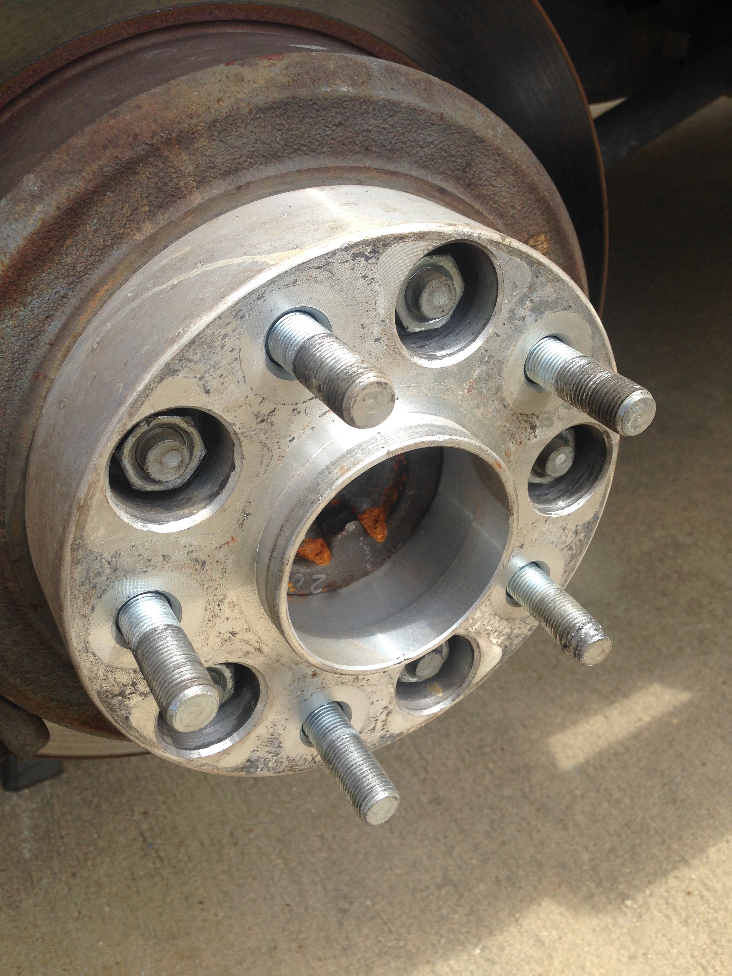

Are your spacers colored? i know my spidertrax can have lugs replaced. As far as them being warped, they may not have been torqued to spec, or may have loosened up. It's important to check wheel torque as a preventive maintenance routine.

Negative on the color ... I looked into a new stud but because the brand was unknown I ordered a set of 1.5" Spidertrax. I figured better safe than sorry and as it is a daily driver (most of the time with a 5 year old on board) I didn't want to risk it. Nothing seems loose, not sure on the torque because I did not install them. You can bet though that they will be VERY CLOSELY inspected every time I rotate them. I didn't think about them being over-torqued, that would probably do it.
Any ideas on why these lugs are so crappy? Are they stock this way? Im replacing them all the way around with solid ones if I can find them ... Searching now.
So just to clarify, in your opinion, this is a mechanical anomaly or a result of a poor install (most likely), not a common failure for this equipment?
Full spacer pic attached.
