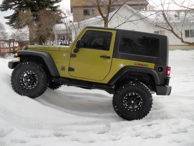

I'm running wheel spacers and have effectively 2" of backspacing and my jeep sits 84" wide. The really tight spots are the only thing I miss. Right now (and even before the spacers) my wheels wouldn't turn any more due to pump limitations...not the steering stops.
Here is the pic I have...

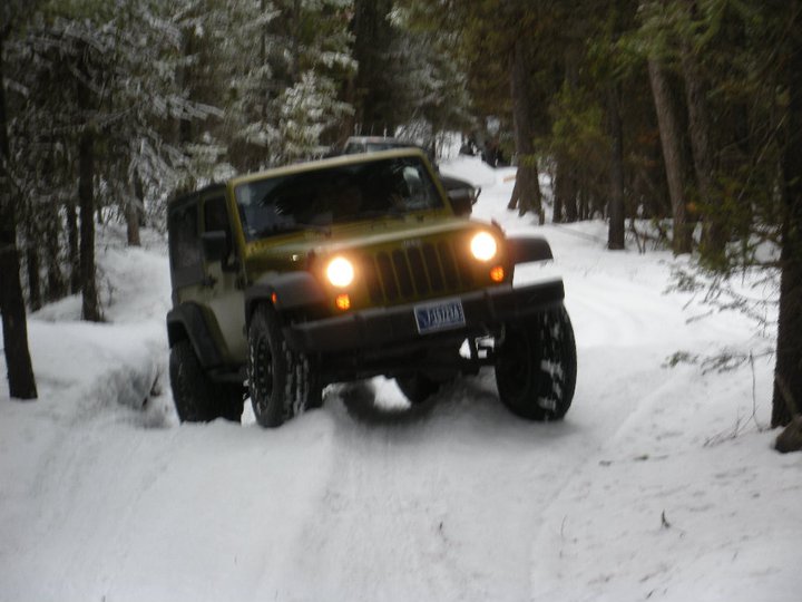

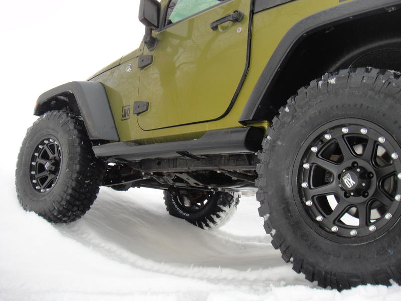

no rubbing what so ever...honestly, just because i want the look of a wider stance i love my tires they are they best ive ever run out of toyo mt and mtr/k and mud grapplers. the bfg km2 is the best. i have them sipped and they are amazing!!! in the winter, snow and ice surprisingly. the only time i rub is when i am disconected i hit the inside of the front bumper at full stuff...a stubby front bumper would take care of that. thanks for the compliment! here you go...

last pic is some winter wheeling...full flex
