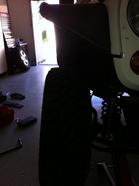

You can definitely tell the difference with the spacers. Can't give an opinion of your ice, snow, or road grime situation though living in SD. These are 1.33" spacers from rugged ridge
ID:	126230   Click image for larger version

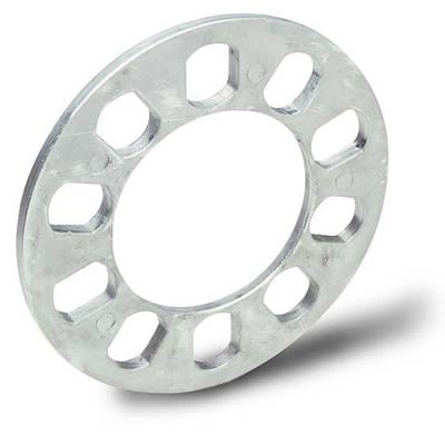

The spacers listed above all have two sets of bolts. (spacer bolts to wheel studs, rim bolts to spacer). Running the thin type that sandwich on the stock studs are generally considered to be unsafe. I haven't seen any 1" spacers with 2 sets of bolts, so just a heads up.

So is anyone running spacers like these?
If the two sets of bolt style spacer is preferred, what is the minimum width of a spacer made for the JK 5 on 5"?
