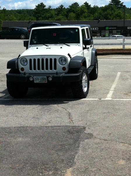

I guess I'm just not sure what these do?
Does it change the look at all on the wheels? Does anyone have a before/after pic of these?

I have them, they make my rims flush with the fenders rather than being stuffed under them and making it look like a narrow trac. Add a lil bit bigger tire and it sticks out just slightly enough to look AWESOME!
