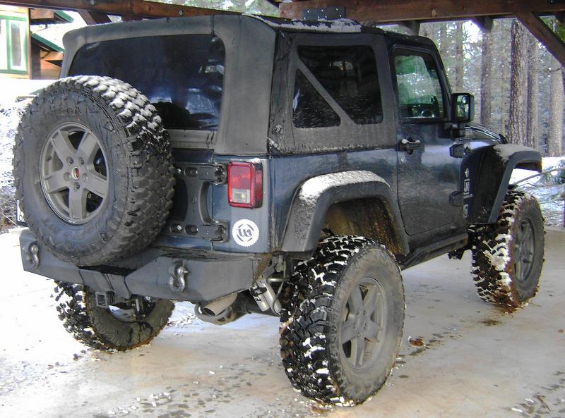

yes, I've had these on for 3yrs plus. Work great, no issues what so ever. All the machined spacers are virtually the same thing, so long as they're hub centric and not lug centric. For me, the wheel spacers are probably the only RC part I'd use. Very happy with the spacers.

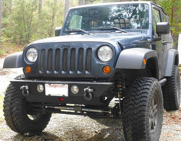

Sorry to thread hijack is that the pavement ends front bumper? If so who makes the front skid plate you have under it.
Btw I have the rough country spacers too and no issues.

yeah the bumper works great. I bought a WARN skid plate that's meant to work with their bumpers, I just eye balled the warn bumper heights and they seemed to be identical height wise to the PE bumpers. Drilled 4 holes under the bumper and that skid fit as if it was meant to. Perfect. I've seen other people also mount up Mopar skids to the PE bumpers. The simple design makes these really versatile and easy to add on to. Might add a hoop or mid stinger at some point too

Thanks on my tight budget that seems to be the best and least expensive to be able to mount a winch to and keep my factory fog lights. I will have to look up that warn skid. It looks like it is meant to go with that bumper.

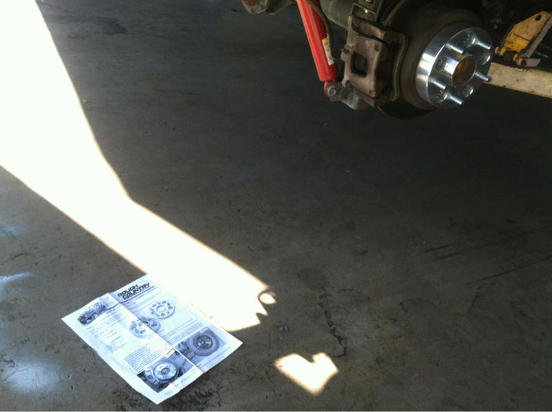

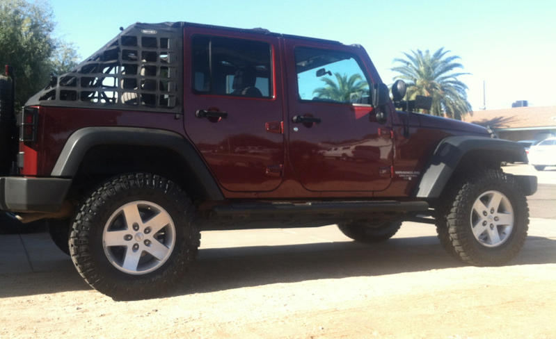

Also running RC 1.5 wheel spacers on my stock wheels with 33" goodyear Duratracs , and very happy with them, like everyone said, use loctite and check them on rotations, they deff make a diff on those stock wheels
