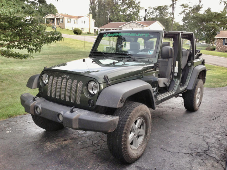

Got my wheel spacers on. What's everyone think?

Old Jun 21, 2013 | 08:17 PM
k0260's Avatar
Posts: 5,234
From: Nevada City California
lookin good! did you go with 1.5"
Old Jun 21, 2013 | 08:21 PM
SupraMatt95's Avatar
Joined: May 2013
Posts: 88
From: McConnellsburg, PA
Yup 1.5" rough country. Thanks buddy.
Old Jun 21, 2013 | 08:26 PM
hooper's Avatar
Posts: 433
From: Rosharon, Texas
Looks good. Keep them torqued and use loc-tite.
