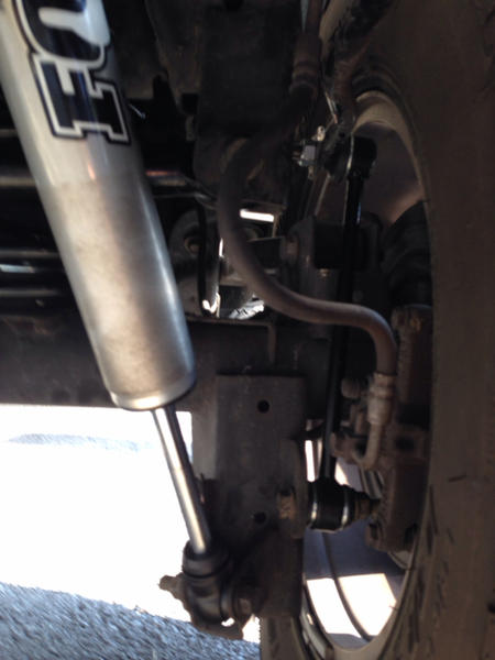

Now I just had my 2.5" teraflex coil lift put on. I was afraid my stock rubicon wheels were going to rub(255 BFF mts) but the front is totally fine and the back doesn't seem to be rubbing. Here's my question if the upper connection of the sway bar link on the passenger side is close but not touching, should I be concerned with daily driving? I want new wheels but need to save some cash and get the ones I want.

Opinions? Thanks in advance!!!

I would definitely wait for the spacers.

Agreed, wait for the spacers. I put them on my 2011 JKUR with RK 2.5 max travel. The rear swaybar link was hitting the inside of the rim just barely. Went to moab and a few other places with no problems. I got the spidertrax BTW.
