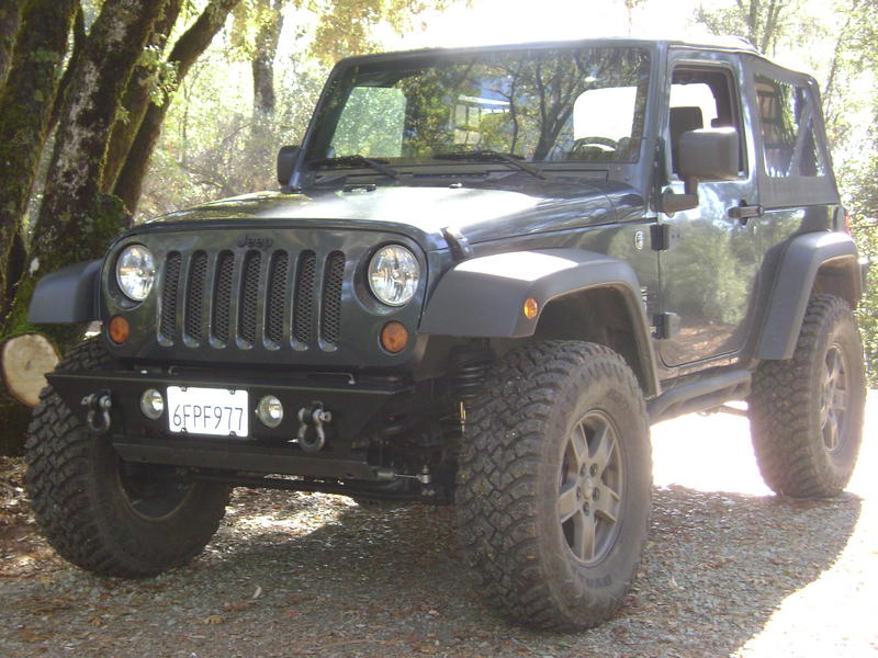

yes wider stance, and allows use of factory wheels with large tires and no rubbing on sway links etc. I've been using 1.5" spacers for almost 3 yrs now. Running OE wheels with 35's, spacers are a must to keep from rubbing especially if you still want full clean flex. All in all, an aftermarket rim with 4.5" +- backspacing would be safer. Spacers are working great for me IMO ofcourse........

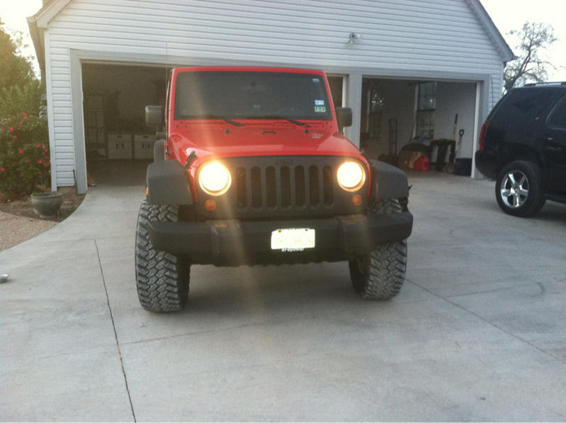

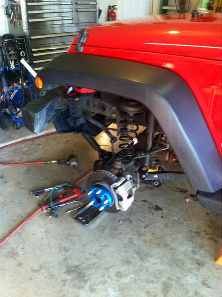

Just put mine on last week, I'm running 35/1250 Trail Grapplers and it would have been a tight squeeze without the wheel spacers. Makes it look a little more aggressive also, I love em
